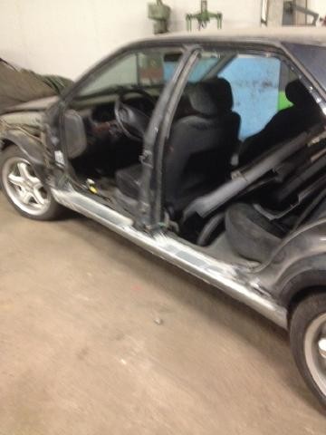

Small update: Xactiva is finally in welding process, both sills are being restaured to perfection with known Estonian maestro. Pics to be posted soon...
 Viestin otsikko: Re: Xantia Activa V6 restoration
ViestiLähetetty: 27.10.2014 15:51

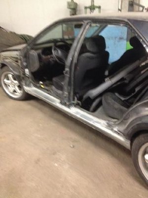

... would be easier to build a new car... Current status:
V__D8FA.jpg [ 31.27 KiB | Katsottu 29250 kertaa ]

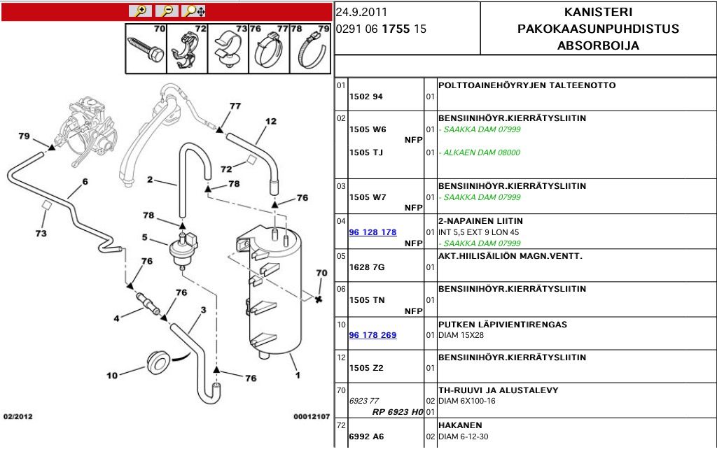

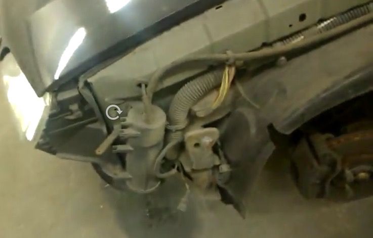

In the end of the video, there is a canister I wasn't able to recognize right away... Anybody know what it is?
ViestiLähetetty: 21.12.2014 22:41
Viestit: 725
Its most likely fuel vapors purge and recycling canister. It has coals cuts inside and its recommended to check coals condition because it should be dry. At same time you can blow to return hose back fuel tank to make sure its free of dirt and particles.

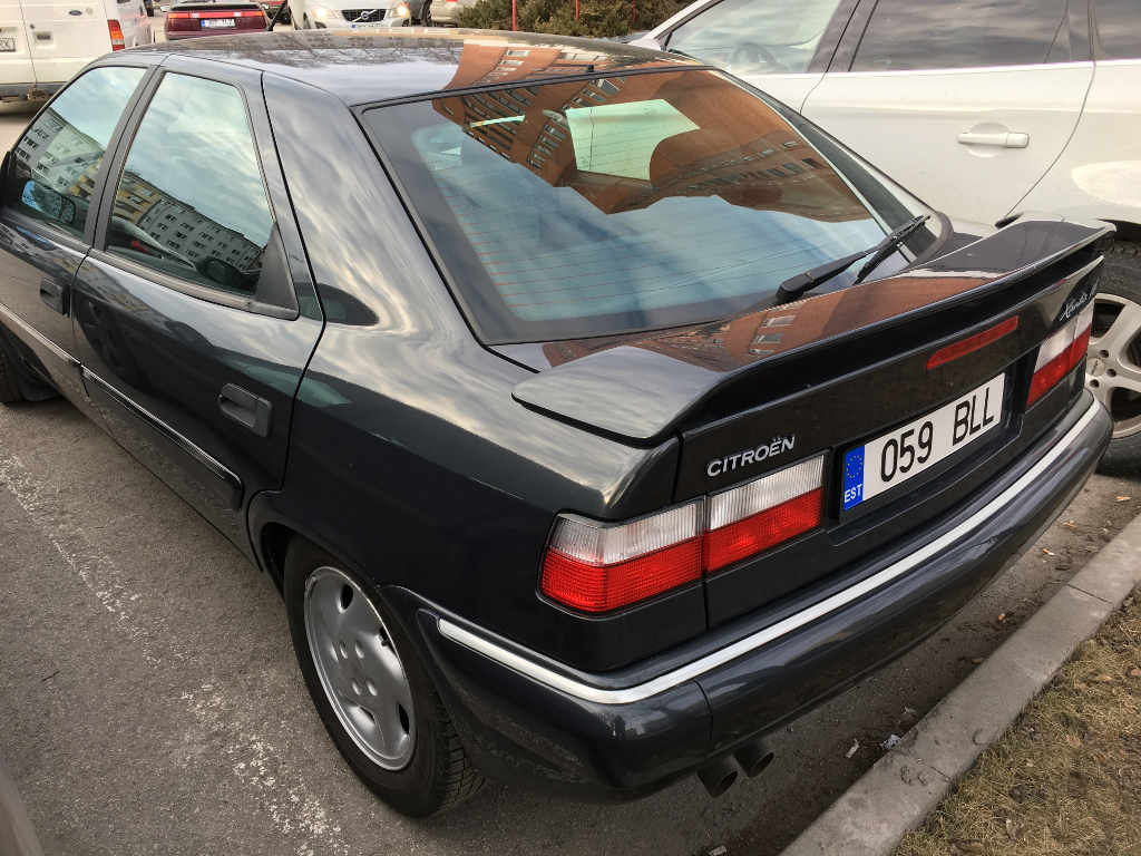

Daytime view from perspective most people see it:
activa-takaa.JPG [ 101.49 KiB | Katsottu 24803 kertaa ]

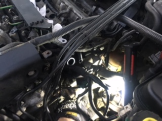

Misbehaving speed sensor in differential casing freaks out the whole car. Engine and activa-system too. Surprisingly speed info provided from ABS is not used in this car for speed sensing - separate sensor is in "nice" place.
Removal, part one:
https://youtu.be/n0CPe7C9pUE
ViestiLähetetty: 03.10.2016 22:02
ds-jekkeri kirjoitti:

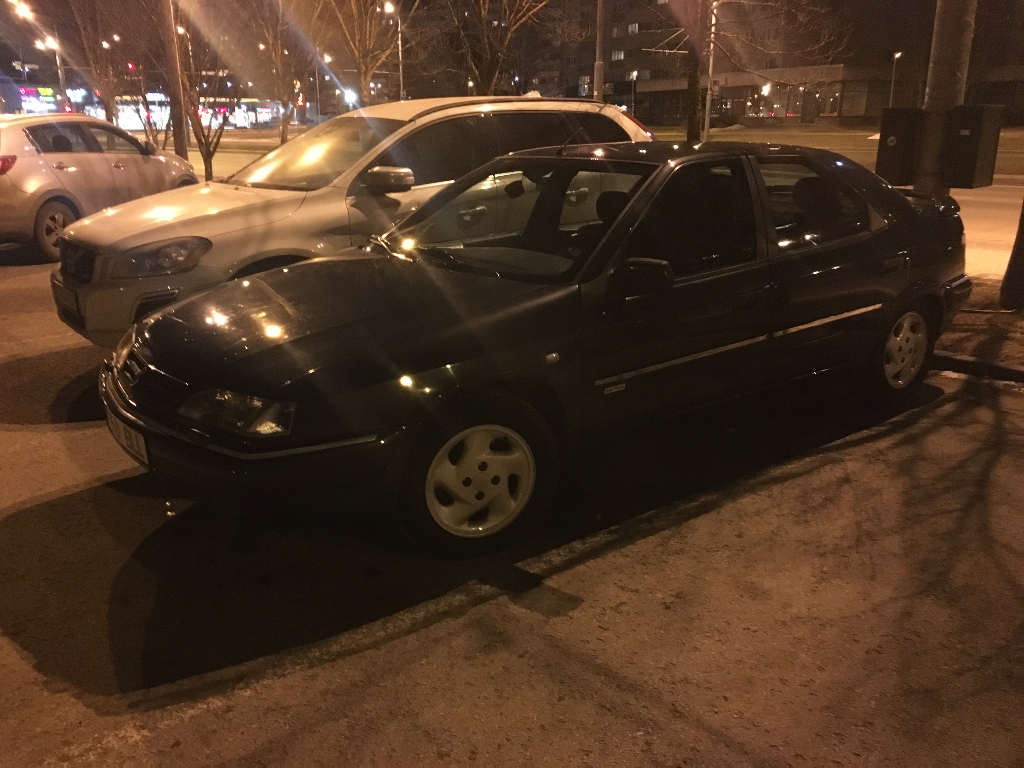

From underside it is very easy to reach...
ViestiLähetetty: 03.10.2016 23:41
Interesting, are we speaking about the same car? Sensor under intake manifold and connector between intake manifold and gearbox, in 5 cm high "cave"?
My hand in the picture reaching for sensor.
image.jpeg [ 49.49 KiB | Katsottu 21792 kertaa ]
ViestiLähetetty: 08.10.2016 22:44
Jasu is most likely correct! The sensor I removed with huge work is RPM sensor that reads the teeth in flywheel - I removed the wrong sensor. Nicely done...
