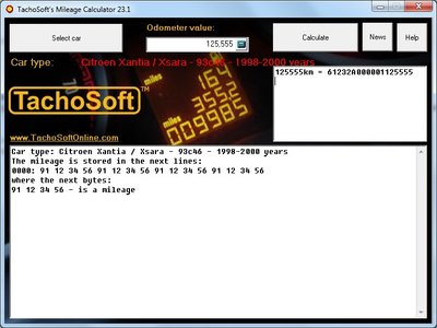

Or then you can just use software like tachosoft to calculate ;)

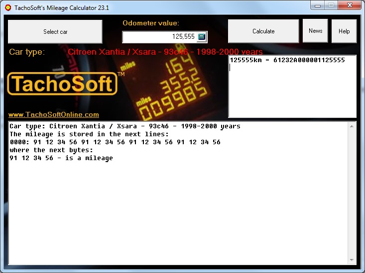

Well, I guess you`re right - but how 61232A00000 is equal to 7, what I need to write it the eprom
tacho.jpg [ 97.95 KiB | Katsottu 2909 kertaa ]
