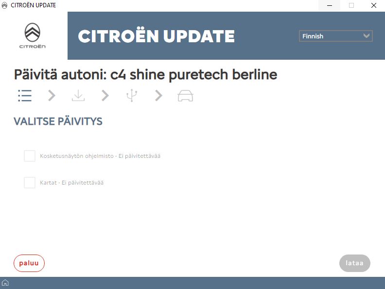

Syötä autosi VIN-koodi ja nyt uutuutena on luotu Citroën Update app, tiedosto, jonka lataat tietokoneelle (Windows ja Mac -versiot). Tiedosto: Citroen_Update_Setup_0.1.24.exe. Koko: 59,8 MB.
Asenna tiedosto, kuva kartta-ohjelmistolatauksesta:
Citroen.fi sivuston KOPS ei tunnista autoni VIN-koodia (VF72RHNZWJ4073118).
Mutta ei hätää, avaa Yhdistyneiden Kuningaskunnan Citroën-sivuston kartta- ja ohjelmistopäivityssivu:
https://www.citroen.co.uk/owner-service ... ion-system" onclick="window.open(this.href);return false;

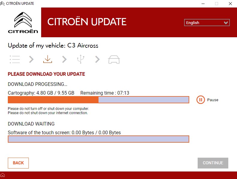

Sain vinkin päivityksestä brittiläisestä C3 Aircross ja C5 Aircross ystävien verkkosivusta.
Siellä todettiin, mikäli lataa molemmat päivitykset (kartat ja firmware) samalla kertaa, asennus ei onnistu (totesin sen itsekin).
Viesti 1:
I have now had a limited good result!
Please keep in mind that the engine and ignition MUST be on the whole time for this upgrade. It is NOT very green and I do not know how much fuel is wasted by doing this.
1. I changed the memory stick I used to a Sony 16GB
2. ONLY [/b ]the System upgrade, 21.08.84.12_NAC-r0, was was loaded and copied.
3. Installation took more than 30 minutes. (Not a good idea when it is cold as there are limited working controls!)
4. The system restarts shortly after it begins and the upgrade and the display goes dark for what seems a long time. DO NOT turn off ignition or remove the stick!
5. The progress monitor is very slow and I recommend, if possible, using a stick with a activity LED to reassure yourself that something is happening.
6. The system will restart and the screen will go blank when you remove the memory stick at the end of the upgrade.
7. This was 'only' a 2GB upgrade and the Map update appears to be around 9GB - I wonder how long you have to keep the engine running for this to take place?
8. I am going to try the map upgrade on its own using the same memory stick and I will post the results.

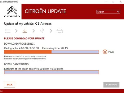

LATAA (JA ASENNA) VAIN YKSI PÄIVITYS KERRALLAAN!
Kartat (9 GB) latautuvat 10 minuutissa, mutta järjestelmäpäivitys (2 GB) kestää lähes neljä tuntia 100 Mbit/s laajakaistayhteydelläkin.

VINKKI: Ladattaessa tiedostoja kytke VPN-tila pois (itselläni F-Secure Freedome). Latautuu nopeammin. INFO: Päivitystiedostot ovat suomenkielisiä myös Citroën Updaten kautta.
VINKKI 2: Kosketusnäytönpäivityksessä auto pitää pysäyttää, ei sammuttaa! Pysäytyksen jälkeen alkaa päivitys. Sekä kartta- että firmware-päivitys tarkoittaa 40 minuutin moottorikäyttöä, joten suunnittele etukäteen "päivitysajoreitti". Molemmat päivitykset eivät asennu samalla kertaa!

Kuten näette, päivitettävää ei löytynyt; kokeiltu 10.07.2024.
