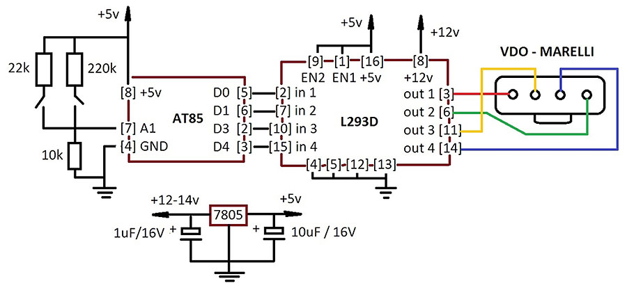

And to shrink little more the project:
- Atmel tiny 85 (@ 16Mghz / 4.8V - PLL)
- L293D
- 10k , 22k, 220k
- 2x push buttons
- 7805 , 1uF , 10F caps
att85.jpg [ 54.65 KiB | Katsottu 6886 kertaa ]
Koodi:
#define motor_pin_1 0 // pin 5  coil 1
#define motor_pin_2 1 // pin 6  coil 1
#define motor_pin_3 3 // pin 2  coil 2
#define motor_pin_4 4 // pin 3  coil 2
int spin[32] = {
1,0,0,0,
1,0,1,0,
0,0,1,0,
0,1,1,0,
0,1,0,0,
0,1,0,1,
0,0,0,1,
1,0,0,1
void setup(){
  pinMode(motor_pin_1,OUTPUT);
  pinMode(motor_pin_2,OUTPUT);
  pinMode(motor_pin_3,OUTPUT);
  pinMode(motor_pin_4,OUTPUT);
void loop(){
     int buttonRead = analogRead(A1);
     delay(5);
     if(buttonRead > 10 && buttonRead < 200){
                 backward();
     }else if(buttonRead > 200 && buttonRead < 600){
                 forward();
     }else{
                 park();
void forward(){
     for(int t=0; t<32; t+=4){
          digitalWrite(motor_pin_1, spin[t]);
          digitalWrite(motor_pin_2, spin[t+1]);
          digitalWrite(motor_pin_3, spin[t+2]);
          digitalWrite(motor_pin_4, spin[t+3]);
          delay(3);
void backward(){
     for(int z=32; z>=0; z-=4){
          digitalWrite(motor_pin_1, spin[z]);
          digitalWrite(motor_pin_2, spin[z+1]);
          digitalWrite(motor_pin_3, spin[z+2]);
          digitalWrite(motor_pin_4, spin[z+3]);
          delay(3);
void park(){
    digitalWrite(motor_pin_1, LOW);
    digitalWrite(motor_pin_2, LOW);
    digitalWrite(motor_pin_3, LOW);
    digitalWrite(motor_pin_4, LOW);
Let the LHM be with you...
